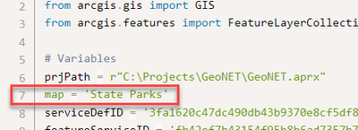

ModernElectric
@JakeSkinner
Been using the latest script to rebuild my update workflow.
On one of my Web Maps/Hosted Feature Layers - using this updated script - why am I getting:
mp = prj.listMaps(map)(0)
IndexError: list index out of range
JakeSkinner
Esri Esteemed Contributor
@ModernElectric do you have the name of the map in ArcGIS Pro specified correctly for the map variable?
ModernElectric
Disregard.
Please forgive my ignorance, lack of proof-reading abilities 😉
Updated Script is working perfectly for updating our AGOL dataset.

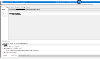

cog_GIS_Admin

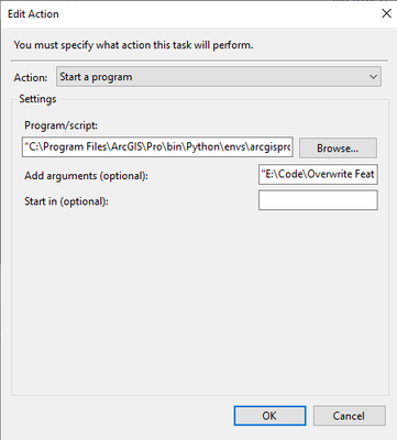

Thanks Jake, that was the issue. Now working on getting it to auto run with the server task scheduler.
JakeSkinner

@cog_GIS_Admin here is helpful document on how use Windows Task Scheduler with python scripts:
https://community.esri.com/t5/python-documents/schedule-a-python-script-using-windows-task/ta-p/9158...

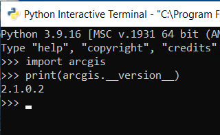

@TomShewring
  1.  Do you have Windows Authentication enabled on Portal's web adaptor?
  2. What version of Enterprise?
  3. What version of the arcgis api for python?

3. I have tried the script with
(i) ArcGISPro 3.3.1 -
and
(ii) ArcGISPro 3.1.4

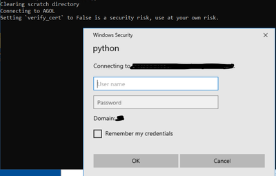

Hi @JakeSkinner , changing to these settings (and using the Portal WebAdaptor address) -
when I run the script from the command line I get a security challenge
So I could not run this as a scheduled task on the Windows server
JakeSkinner

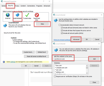

@TomShewring this should not occur if you're running command prompt as a named user in Portal, and you have Portal's URL added to the Local Intranet (i.e. Start > Internet Options > Security tab > Local Intranet > Sites > Advanced > specify the portal URL (minus the web adaptor) > Add):
TomShewring
@JakeSkinner thats sorted it. Thanks.
Although we had deployed the Local Intranet change to all users, it had not been deployed on the server running the Overwrite (Portal) Feature Service script. Thanks for your help. Much appreciated.

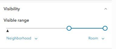

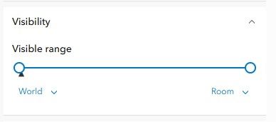

Hi @JakeSkinner
I am running into this AGO bug, BUG-000171689, https://support.esri.com/en-us/bug/after-truncating-the-feature-layer-the-visibility-scale-bug-00017... "After truncating the feature layer, the visibility scale range of feature layer has been unexpectedly reset at the REST endpoint" when I run an ArcGIS Pro model that truncates and appends my hosted feature layer in AGO. So I thought I could use your script as a work around. Your script is great - but it still resets the visibility scale range for the feature layers in AGO.
visibility scale orig before overwrite.JPGvisibility scale orig before overwrite.JPGvisibility scale after overwrite script.JPGvisibility scale after overwrite script.JPG
If I do a manual Overwrite Feature Layer using ArcGIS Pro - it keeps the visibility scale range for my layers. But I need to run this as a script nightly.
Are you able to add this to your code to keep the visibility range on the layers?
I'm not sure how else to work around this at this point.
***Edit - And.....nevermind. Your script works as a perfect work around and it does maintain the visibility range. I had unknowingly run the Model after your script so I had bad results.
Thank you!

Hi @JakeSkinner ,
The .py seems to run in Windows task scheduler because the item detail page in AGO says "item updated" with today's date. But the Last Run result in Windows Task Scheduler says 0x1.
Do you have any ideas?
Thanks,
A

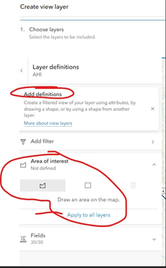

AndreaB_
Hi @JakeSkinner ,
Thank you for testing it out. I just did some testing also with Pro 3.6.1. The issue is: the feature layer has a View Layer created with an Area of Interest defined within it.
When I create my View Layer in AGO:
This blocks overwriting of the feature layer. 🛑
Esri tech support has provided some links:
I am VERY surprised this is expected behavior. I would expect this to be a bug and functionality that needs to be fixed as soon as possible.
