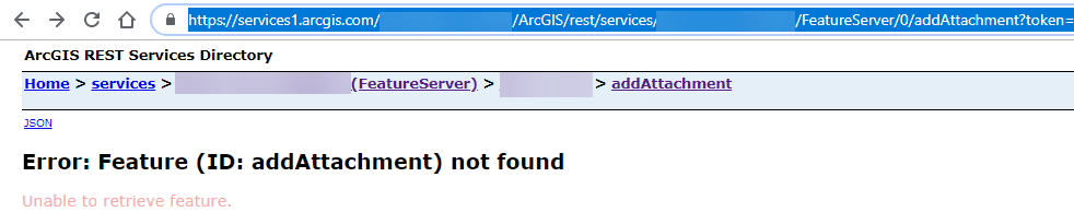

Has anyone used the REST API to POST an attachment (photo.png) to a Feature Service using `addAttachment`? The documentation seems incomplete.
In Postman:
- Method: POST
URL: https://services1.arcgis.com/<serviceName>/ArcGIS/rest/services/<name>/FeatureServer/0/addAttachment?
- POST Params: `token` : `<myToken>, `f` : `json`
- POST Body:
    - Tried `form-data` with `key` : `attachment` and `value` : `file` and selected a .png file. DID NOT WORK
    - Tried `binary` and selected a .png file. DID NOT WORK
- Response
    "error": {
        "code": 400,
        "message": "Error: Feature (ID: addAttachment) not found",
        "details": [
            "Unable to retrieve feature."

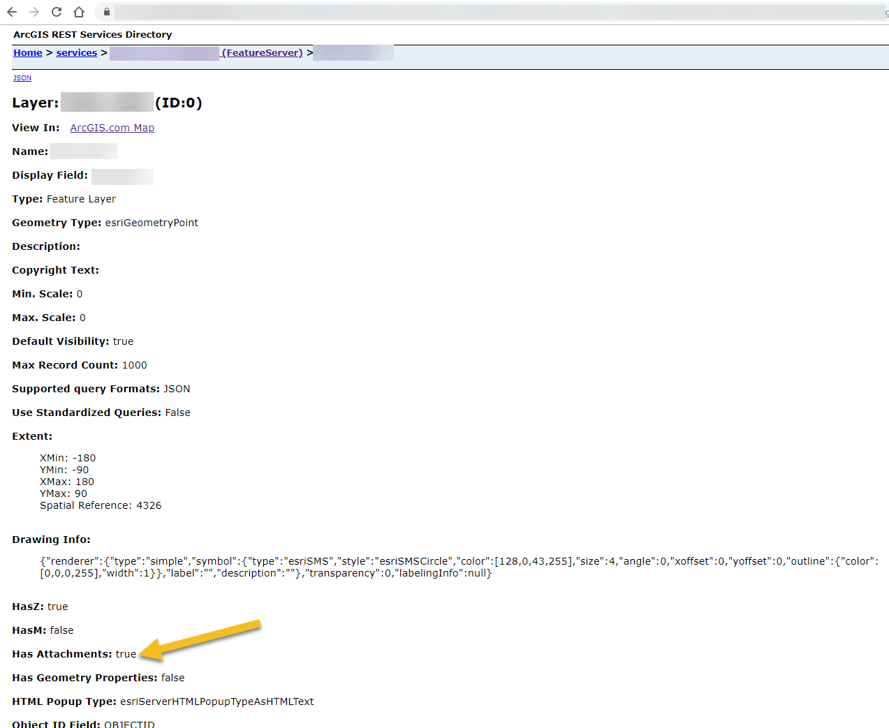

The documentation states that "...This operation is available only if the layer has advertised that it has attachments. A layer has attachments if its hasAttachments property is true."
My feature service seems to have hasAttachments set to true...
...but the error is shown when I put this url into the browser:https://services1.arcgis.com/<serviceName>/ArcGIS/rest/services/<name>/FeatureServer/0/addAttachment?
Can anyone see what I'm missing? Have any insights?
Thank you
Good morning Eric,
Some insights:
  • You don't add an attachment to a feature service, but to a feature service feature resource instead, so you URL should contain an ID of a feature to add the attachment to.
(From the documentation:
Add an attachment using the addAttachment operation on a feature service feature resource. In this sample URL, the addAttachment operation is performed on feature ID 818654 belonging to layer 0 of the 311Incidents feature service:
https://services.myserver.com/ArcGIS/rest/services/SanFrancisco/311Incidents/FeatureServer/0/818654/addAttachment
... but further explanation is missing)
I don't know if you are into Python, but you might be interested in the work of Caleb Mackey‌, who is the author of restapi, a Python API for working with ArcGIS REST Services, which is actively maintained on https://github.com/Bolton-and-Menk-GIS/restapi
Please let us know your solution, when you have found it.
HTH,
Egge-Jan
