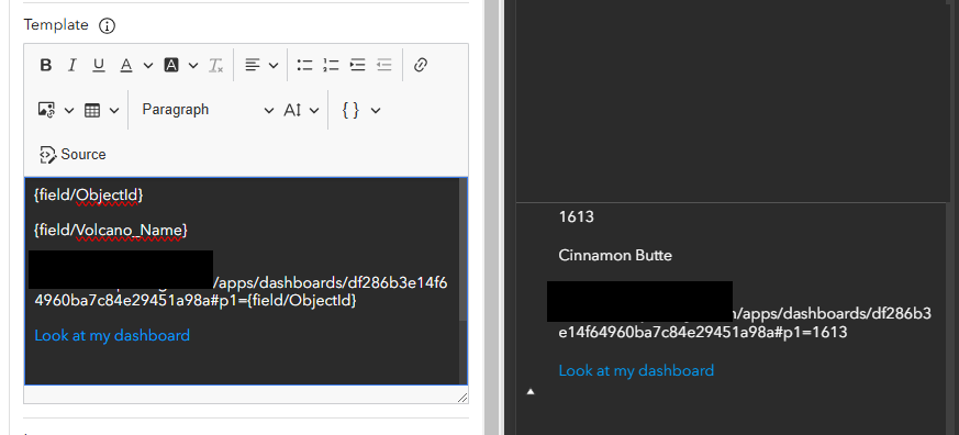

How are you providing the link? I'm assuming it will be via a List element. Just build the link in the list template, and use the field reference for the field used in your dashboard parameter.
To create a hyperlink, just copy the link (w/ the field reference). Add your hyperlink text, highlight it, and click the link icon. Then paste your link into the box. You can then delete the original link.

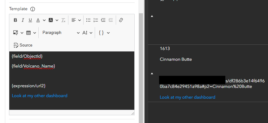

If you are using a field in your parameters that has spaces or special characters in it, you will need to use Arcade the encode the URL.
var url = 'https://portalurl/apps/dashboards/df286b3e14f64960ba7c84e29451a98a#p2='
var field = UrlEncode($datapoint.Volcano_Name)
var url2 = Concatenate(url, field)
return {
  textColor: '',
  backgroundColor: '',
  separatorColor:'',
  selectionColor: '',
  selectionTextColor: '',
  attributes: {
    url2: url2
This time, you would just reference the expression variable for your hyperlink.

jchadwich1
You're correct, I am adding the links within the list widget. This looks like exactly what I was looking for, I'm going to test it out now.
