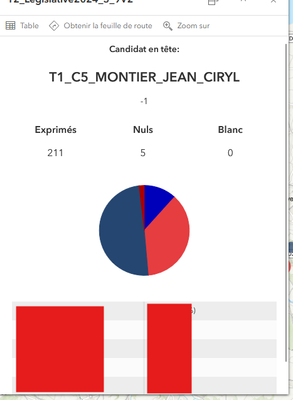

In my case, i have a list of candidats for an election, but i only have their names, so i have a 80 lines expression that take their names, and get from another list their political group, the group color, their percentages and this fat expression is later used into 4 expressions to make html to make the results more human readable (for instande, a diagram, a fancy display with their image, etc...

I don't really know if i can publish it now, but yea, i already use Arcade popup like so:
