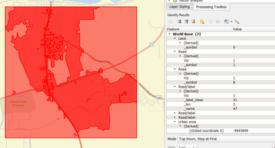

Consider the world basemap vector data here:
Note that's QGIS shown there, which can interactively browse a vector tile service's features.
Each "feature", such as it is, only has the attributes "Viz" and "_symbol". Vector tile features may have additional attributes, but not always. Esri's vector tiles typically don't. Additionally, labels are their own features in vector tiles.
