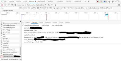

I'm currently experiencing a problem implementing OAuth 2.0.  The application is written in HTML, CSS, and plain JavaScript but here's where it may get interesting... The code is then placed within a single Media Content Web Part within Sharepoint.  I don't believe a lot of the Sharepoint integration materials are relevant to my particular set up since ArcGIS isn't within its own webpart - it's just coded within the JavaScript and placed on the page within a viewDiv.

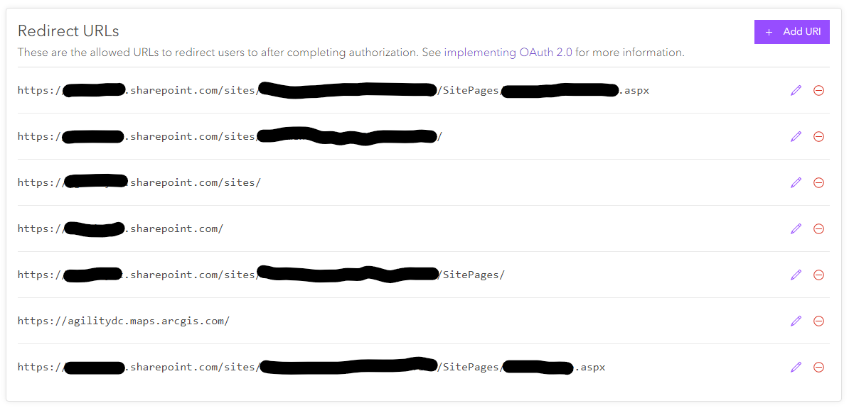

I have referenced this specific documentation page probably 100 times and believe I have followed all of the steps exactly.  I have also gone within my Developer Dashboard, registered the application, and tucked my site's URL within the "Redirect URLs" trying multiple ways including with trailing slashes and without.

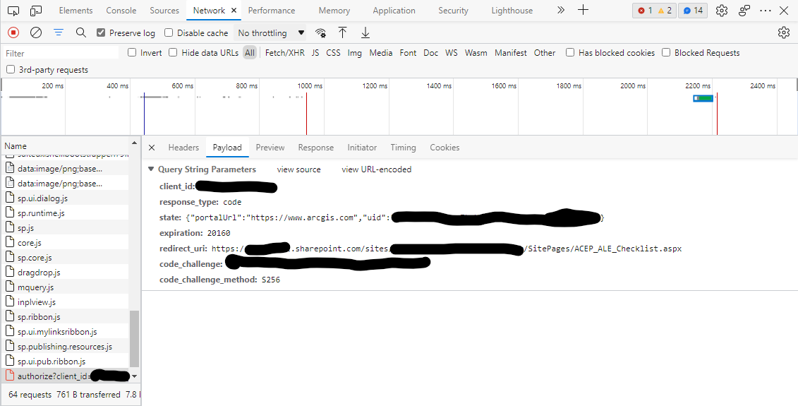

I have confirmed the redirect_uri value in the Network tab and it does match one of my Redirect URIs within the application.
I've tried to isolate mainly the auth portion itself away from the rest of the code for testing purposes and this is what I have:

Well as embarrassing as this is... I discovered the Client Id was incorrect.  Leaving up as a reminder to check Client Id if you run into this error.
