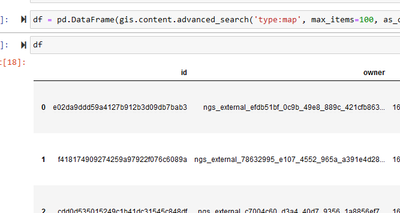

You could use advanced_search to return a dict, then convert that to a DataFrame:
pandas.DataFrame(gis.content.advanced_search('type:map', max_items=-1, as_dict=True)['results'])
The resulting frame has id as one of its columns:

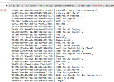

If you just wanted a list, though, you could use list comprehension together with the search method:
[f'{i.id} | {i.title}' for i in gis.content.search('', item_type='Web Map', max_items=-1)]
