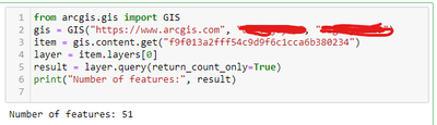

@JoseSanchez, might be late response, but I hope, this answers your question:
from arcgis.gis import GIS
gis = GIS("https://www.arcgis.com", "username", "password")
# Access your feature layer
item = gis.content.get("<ITEM ID>")
layer = item.layers[0]
result = layer.query(return_count_only=True)
# Print the count of features
print("Number of features:", result)

JoseSanchez
Thank you @GeeteshSingh07
This is  how I did  it:
