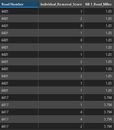

Script verifies but won't save because of an error on line 13 "Attribute value lookup error". I have used this exact script without the GroupBy() function just fine so I'm at a loss. I'm assuming the GroupBy() table isn't being returned properly so there is nothing to reference? Wondering if the field "Total_Miles" needs to be created physically somewhere or if it gets created in memory while its running. The way I understand it is the GroupBy() function creates a new temp FeatureSet. I thought I was creating a FeatureSet with RoadNumber and Total_Miles (being a sum of "Individual_Removal_Score") as the fields but my thinking is that it's breaking down because there are multiple entries with the same roadnumber? (Screen shot example of the table I'm attempting to group below)

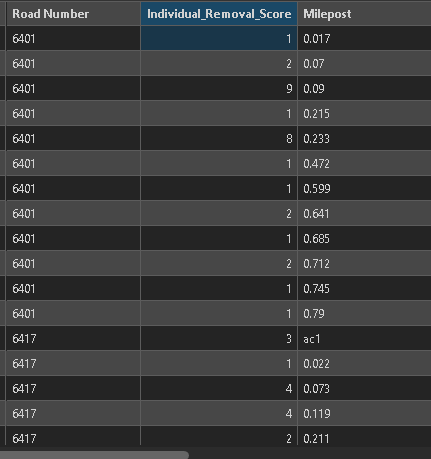

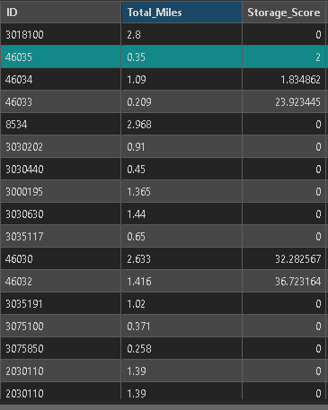

I do have a field in the sourceTable that has the mileage of the road based on the roadnumber. I guess I'm not sure how it would display properly because the sourceTable is a point layer and the target layer is a line layer. Both layers have their own fields with the total mileage of the road (not shape length). If I were to GroupBy() the ML1_Road_Miles wouldn't that just sum the mileage and not have it a single value? Thats why I had it referencing the line FeatureSet "Total_Miles" as a variable. Maybe an average instead which would give it the correct value?
Below is a snip of the line FeatureSet. This script is writing to the "Storage_Score field
Below is a snip of the point FeatureSet "sourceTable" w/ the Road Mileage

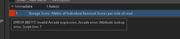

Even still the filter function displays an error on line 7. Below is how I have it now, but it doesn't seem right.

What is the error you're getting on line 7?
amrodri01
Gotcha, okay with the original script it was referencing line 11. Just kind of weird since it only shows in the attribute rules pane and not in the expression entry window.
