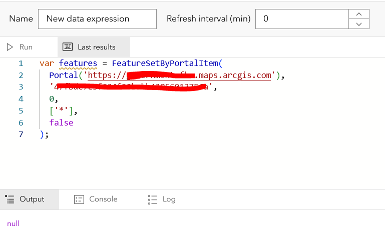

I am trying to create a Data Expression within an AGO Dashboard (current dashboard, not classic) serial chart and I am having trouble getting a layer so I cna build an expression around it. I have seen numerous examples using the following example:

I have ran the expression using my own organizational account and item id but it returns NULL:
I believe the issue is, I do not have ArcGIS Portal, so I don't believe I can use the FeatureSetByPortalItem function.

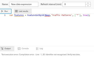

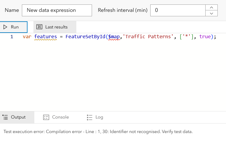

I have tried some of the other functions (i.e. FeatureSetById, FeatureSetByName, etc) to get my feature service, but I keep getting errors. It does seem to recognize the map in my dashboard using '$map'. I have also tried '$datastore'.

 Next, I was receiving NULL because I did not return the item. Needed to add
return layer
Finally, after returning the item, I was getting weird behavior. It was returning a table that was not associated with the item ID. Like...a totally different table! I tripled checked the item ID and event tired some random ones fro data my organization holds. Still, the wrong table each time. Turned out, you need to add the layer ID after the item ID.  So, I had to change the FeatureSetByPortalItem itemID from 0 to the id of my layer.
