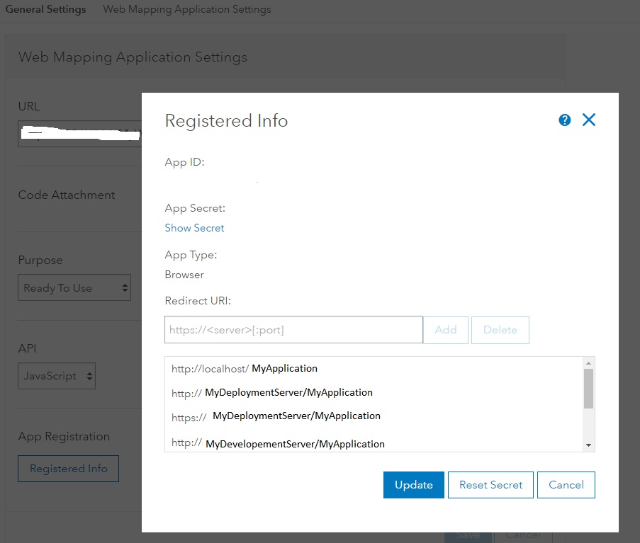

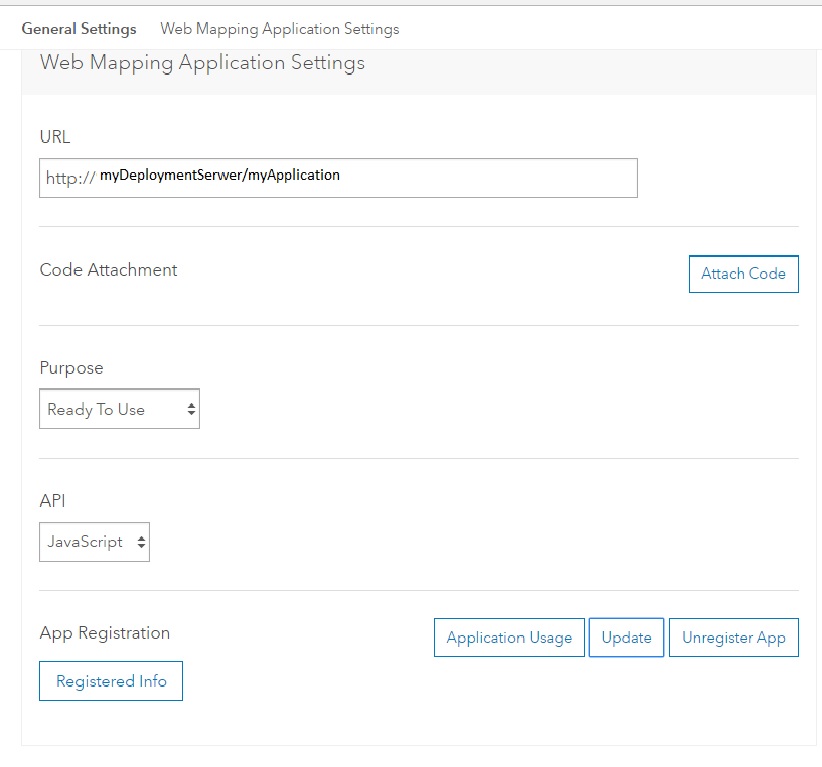

Finally the issue was in the web mapping application located in our  [http://[MyCompany].maps.arcgis.com ] and used by the application in the  config.json "appId" . It was referencing another server, not the one I am currently deploying.
 To correct this issues this is what  I did:
 -  select the tab "Settings" and verify that the value URL in
Web Mapping Application Settings points to your web application.
 - Also please check the
App Registration
and add your new server in the list of servers.
See attached jpg images for additional information.
