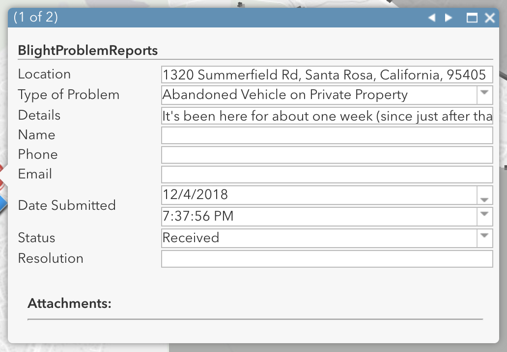

I'm very new to ESRI - and I'm hoping to find *some* way to pull this form into a uniquely addressable page so that it can quickly be edited/triaged by staff:  (more below)popup screengrab
...it doesn't work for me to have this form ONLY be available by clicking an icon once you're on a web-map... there might be dozens of icons on a map, and staff need to be taken directly to edit the specific item like this.

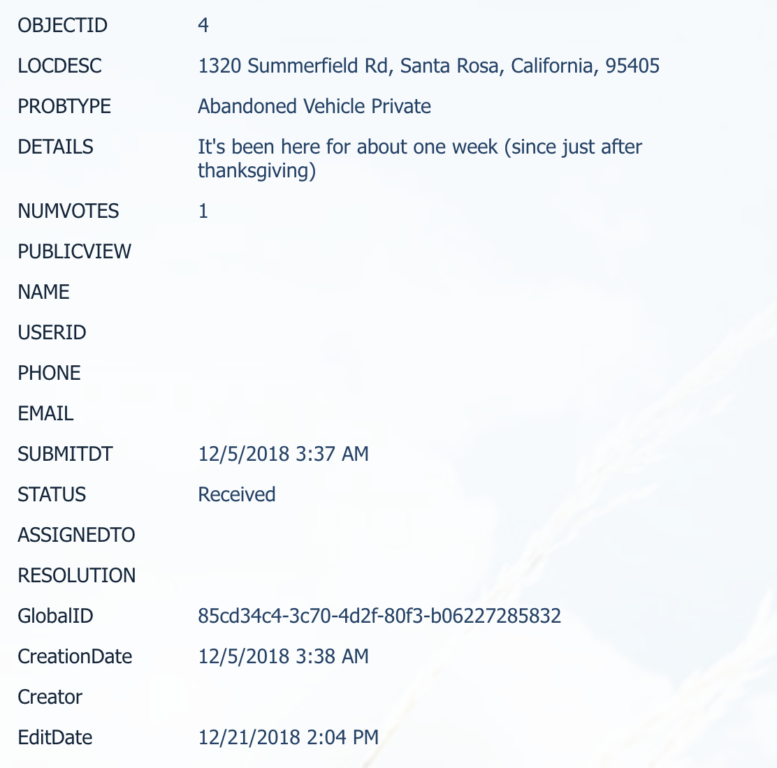

Sharepoint data from above issue:
sharepoint data from AGOL via FME
