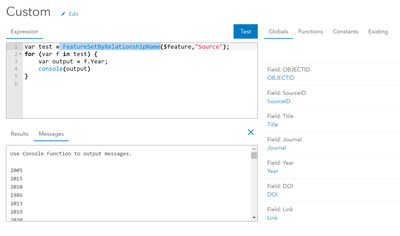

Since you're working with a related table, you have to use FeatureSetByRelationshipName to get the values in that table. Here's an example (and the output):
var test = FeatureSetByRelationshipName($feature,"Source");
for (var f in test) {
    var output = f.Year;
    console(output)
