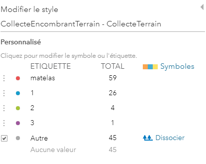

However, when I go to the symbol styling menu, there is only the category "matelas" and "other" available. The categories of $feature.collectefaite are not available.
This is really weird, because if I slightly modify the Arcade expression using greather than 1 instead of 0. It's working.

Let's exclude something first. Your field "matelas_quantite" is numerical, right? Can you also try to change $feature.matelas_quantite to $feature["matelas_quantite"]? There can be some issues when a field contains an underscore in the name.
What would work best for me if I had access to the data to detect where things might be going wrong. Is it possible to share the web map and data with me using my AGOL account "xbakker.spx"?
