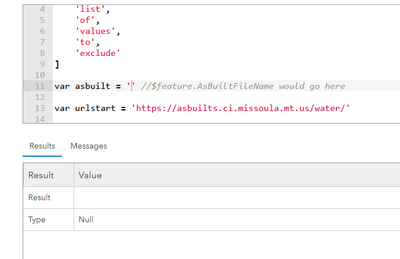

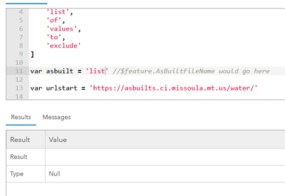

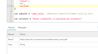

Here's me testing it against a couple of static values and a null value.
- Josh Carlson
