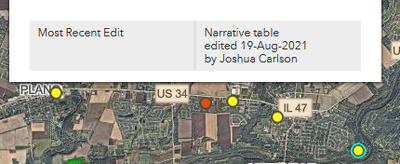

 And after all that, here's the output:
It may seem like a bit much for three lines of text, but now the user who oversees this program can get at a piece of information they want in a single click.
