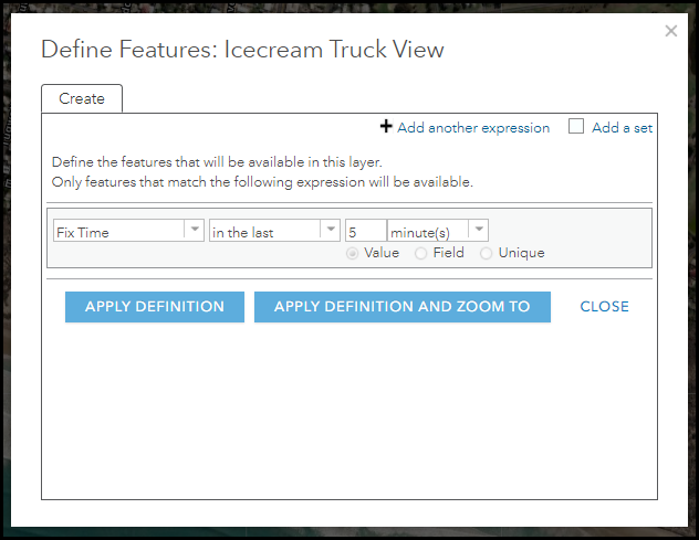

  5. In your web map, open the drop-down menu for the View Layer > Set View Definition > Define Features
  6. We can then use the 'Fix Time' attribute (created by QuickCapture) to set an expression to only display the points that have been streamed in the last x amount of time, such as:
    Fix Time - In the last - 5 - minutes
  7. Furthermore, we want to set our 'Refresh Interval' on this layer, to the lowest possible (every 30 seconds) so that the web map is up to date as often as possible for our web app audience...

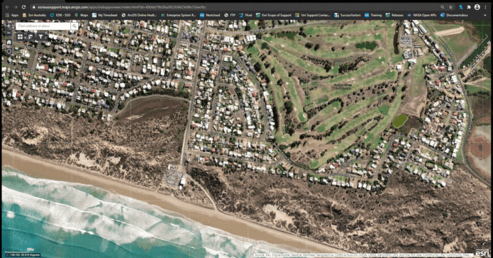

Now we (or the field worker) can begin streaming their location from ArcGIS QuickCapture, and their movements can be observed to update every 30 seconds in the web application, with their location over the past 5 minutes trailing behind them!
Example:
Example Output: Points collected in QuickCapture with a 10m Distance Threshold and public Web AppBuilder app with an 'in the last 0.5 minutes' Filter widget enabled, for a car driving through a local neighbourhoodExample Output: Points collected in QuickCapture with a 10m Distance Threshold and public Web AppBuilder app with an 'in the last 0.5 minutes' Filter widget enabled, for a car driving through a local neighbourhood

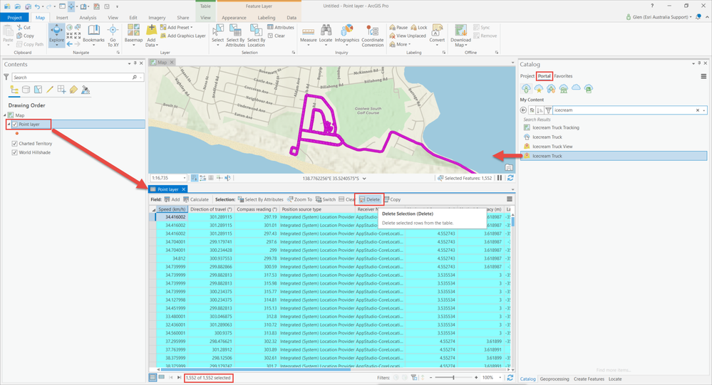

Storage Concerns: Streaming and storing features in bulk using ArcGIS QuickCapture is going to have an increasing impact on ArcGIS Online credit consumption over time. We need to remember to batch delete the collected point features once they are no longer relevant to our purpose. This can be done easily in ArcGIS Pro by doing the following:
  1. Open ArcGIS Pro, connect to ArcGIS Online as your 'Active Portal' and sign in.
  2. Go to the 'Catalog' pane, and on the 'Portal' tab, find your streaming feature layer.
  3. Add this layer to the map, right-click it in the 'Contents' pane and open its attribute table.
  4. Ctrl + A will add all features to selection.
  5. Then click the 'Delete' button to remove them.
