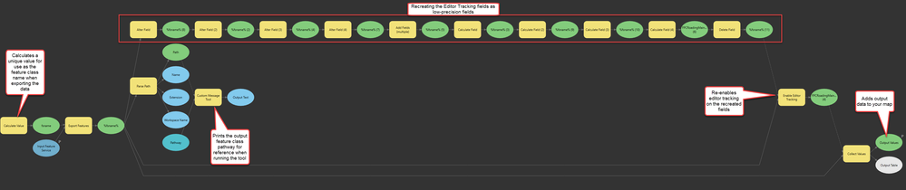

You may have seen recently issues around Editor Tracking fields and new default high-precision date fields in ArcGIS Online (Solved: Editor Tracking – High Precision Date Fields issue... - Esri Community). To mitigate these issues and speed up the process as much as possible, I built a model builder tool that would download each sub-layer/table in a feature service and recreate the Editor Tracking fields, preserving the creation/editor history and enabling editor tracking on the local (temp) data prior to publishing. This speeds up 's Solution in the above post. These tools are attached for download (one for feature services with and without tracking and one for tables with tracking).
NOTE: It looks for the default Creator/CreationDate/Editor/EditDate fields created in ArcGIS Online. If your fields vary from this, the model will need to be modified to recognise these.
Model to download feature service and maintain editor trackingModel to download feature service and maintain editor tracking

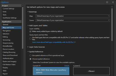

  • Consider using the setting Project > Options > Map and Scene > Spatial Reference > “Choose spatial reference” instead of “Use spatial reference of first operational layer” to prevent the map changing to a different spatial reference when adding data

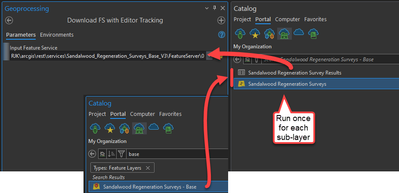

  2. Run “Download FS with Editor Tracking” tool (W:\Mapping.atbx)
    NOTE: Select the input feature service by browsing through Portal – don’t select the layer in the map. Ensure you select the sub-layer so that the URL has the layer ID number at the end (e.g. /0)
    • If the tool fails, it is due to the layer not having matching Editor Tracking fields. Run the version of the tool called “Download FS without Editor Tracking” or update the tool to match your editor tracking field names.
    • If a feature service has more than one sub-layer, run this process for each sublayer.

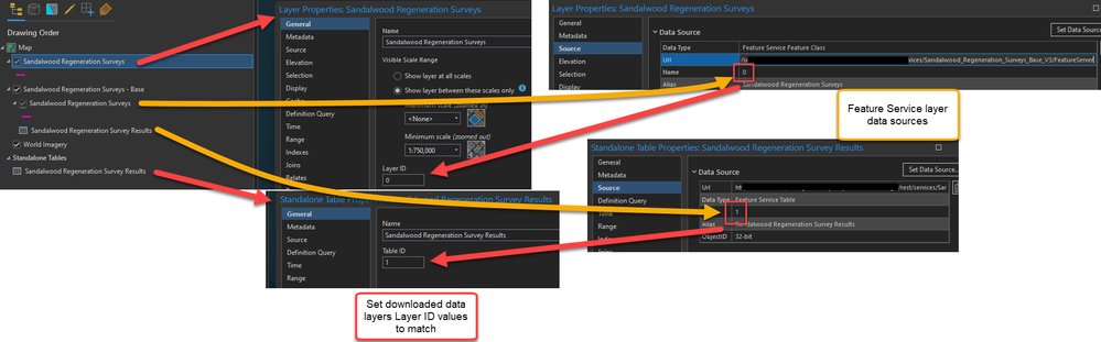

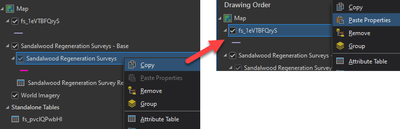

  3. Right click feature service layers you added to the map in Step 1 > Copy then right click the corresponding layer/sublayer output from Step 2 > Paste Properties. Repeat for each downloaded (temp) sublayer until all are are done.
  4. Rename the layers to match the existing feature service sublayers.
  5. Update the new layer properties to match the feature services ID (number) at the end of the service URL (data source) – ensure you do this last as “Paste Properties” will change this
  6. Remove the layer added in Step 1 (existing feature service) leaving only your temporary data

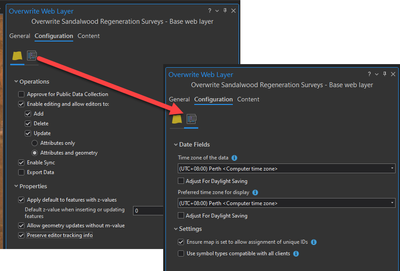

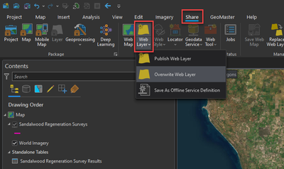

  2. Go to the Share ribbon > Web Layer > Overwrite Web Layer
  3. Select the original feature service and click OK
  4. In the Configuration section, ensure you check the “Preserve editor tracking info” (unless no editor tracking was found when downloading the feature service)
  5. Update the Time Zones (if required)
  6. Analyse the layer for any errors and rectify as required
  7. Publish the feature service

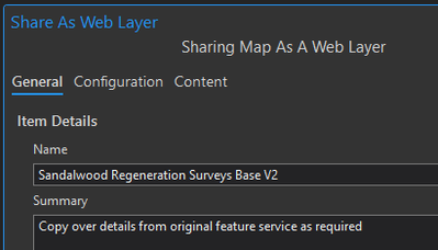

  • We found that some of our feature services simply refused to be overwritten. These ones we had to publish again from scratch (with "V2" appended to the name - see screenshots below). It's important to remember that you can't change the source of a hosted view to another feature service unless they have the same spatial reference as the original, and all the required fields are present (amongst other things - further reading here: Swap the source of a hosted feature layer view—ArcGIS Online Help | Documentation). Because we were going through this process in order to update spatial references, this meant publishing the V2 layer with the original spatial reference (e.g. GDA94 MGA Zone 50), changing the sources of all the views to the V2 feature service, and then we would go through the above republish (overwrite) process again on the V2 layer to update it's spatial reference (to WGS 1984 Web Mercator) with much more success.
