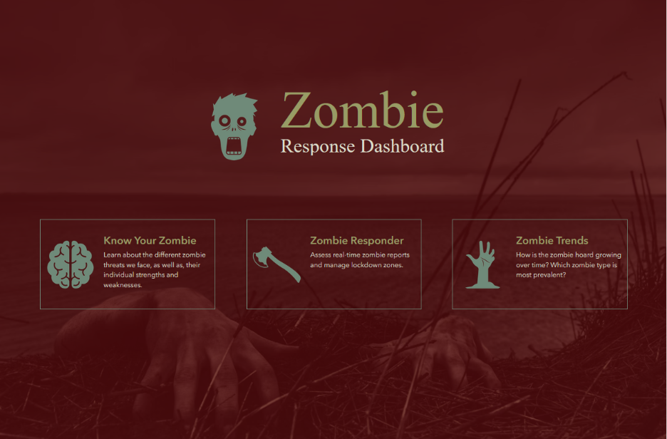

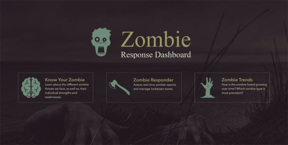

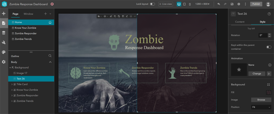

This Zombie app uses a text widget, with no actual text in it, to add a colored “filter” to the background image. The text widget is not being used in its intended manner, but it adds so much to the overall look and feel of the app. It helps tie in app theme and colors, as well as increases the contrast between the actual text and the background image.
Sneaky Text WidgetSneaky Text Widget

For example, let’s say our GIS survivalists developed a threshold at which zombie prevalence triggered a code-red alert. They want to change the app home page theming to quickly indicate that a code-red has been triggered. Using our problem solving approach, they realize that the text widget does exactly what they need – even without any text. Using Arcade, they conditionally turn the text widget background color to a semi-transparent red tint during a zombie ‘code red’ alert, driven by their zombie trend data – quickly changing the look and feel of the app’s landing page to communicate urgency at-a-glance.
Zombie Response Dashboard - Now with more red!Zombie Response Dashboard - Now with more red!
