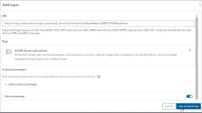

  • Click Add layer from URL and enter the URL of a layer from the web, such as an ArcGIS Server web service.
4. Do one of the following to add the layer as a basemap:
  • If you browsed to the layer, click its name and click Use as basemap.
  • If you entered a URL, turn on the Use as basemap toggle button and click Use as basemap.
The layer is added as a new basemap for the map and the map is now displayed in the projection of the new basemap.
