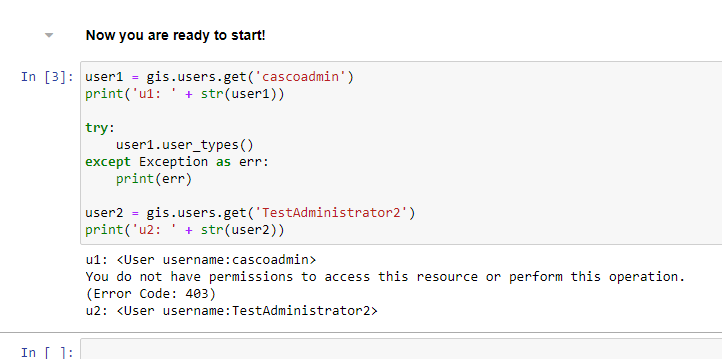

According to the ArcGIS Python API doc the user object should have an orgId property (user.orgId) but I haven't been able to get that to work - I'll look into that separately. One option is that you could ignore the error by surrounding the logic in a try/catch like below and printing the error message rather than having the code break because of it:
Let me know if you have anymore questions.

Is the error still happening even with this line commented out? When is the error being called?
 #items=user_obj.items(folder=None, max_items=1000000)
I suspect there would be authorisation issues when attempting to grab all the items associated with the external user. Or maybe it's when you try to get the user type of the external user.
AsafEvenPaz
The error is happening when I call user_types=user_obj.user_types() so it is related to the user type of the external user. Can I exclude users that are not from my organization when I make this call?

arcgis.gis module — arcgis 1.8.2 documentation
AsafEvenPaz
Thanks - the "try catch" option worked
