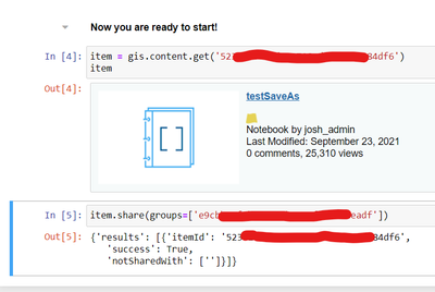

Hi Stuart, it appears your syntax is correct from what you've shown. See below for a working example. Is it possible your 'fc_item' variable isn't a valid item? What is 'search_for_batch_reports[0]'?

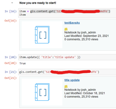

Regarding changing the title of an item, see the below code. Also see the relevant documentation here (note: it appears the example given here is broken - you cannot pass description, title, etc. as arguments. They must be inside a keyvalue pair dictionary):  https://developers.arcgis.com/python/api-reference/arcgis.gis.toc.html#arcgis.gis.Item.update

got the sharing to work using this:
gis.content.share_items(items=search_for_batch_reports, groups=['5e................e68'])
