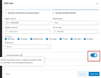

JakeSkinner
Esri Esteemed Contributor
Hi @JiříKomínek when configuring the scheduled task, check on the Use workspace option:
