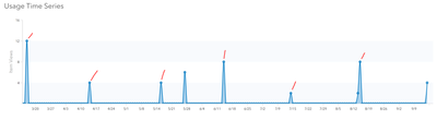

We appear to have encountered a similar situation this morning. Task set up to run at 5am monthly. The notebook runs if triggered manually. It just didn't fire at the set time on it's own, as scheduled to do.
The last peak is from a manual run.
DarrenLloyd__DOIT
Update to @ConradSchaefer__DOIT_ (team member) issue. The scheduled task ran last night (Sept 16th) at 2:30am however the task was scheduled to run on the 15th of the month at 5am. @Anonymous User
