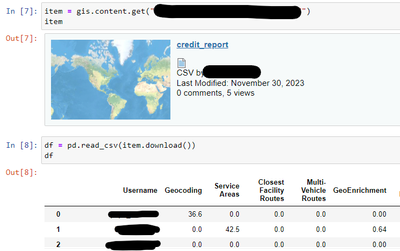

For accessing the CSV as an Item you just missed the .download() operation in order to convert it directly into a Pandas data frame:

Thanks Tom, your solution to get the csv item into a dataframe was priceless. Greatly appreciated as well.
