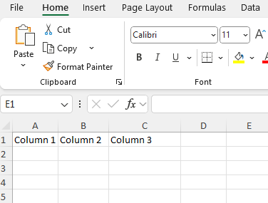

wb.save(filename=myexcelfile)
wb.close()
This should add your data to the excel file.  You spreadsheet should have column names for your data. eg.
