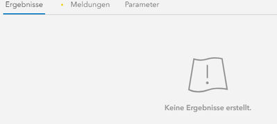

When I run my script in the notebook, I get the desired results. Furthermore I can publish the notebook as a webtool and run it in ArcGIS Online without any error message. The webtool also runs, but unfortunately no results appear on the map. No error message appears in the webtool history either.

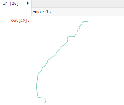

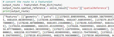

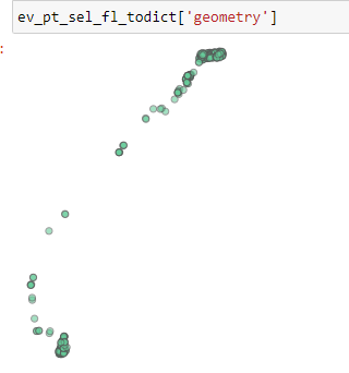

I have changed the coordinates of the input points as well as the name so that they represent German cities. The workflow to generate the route is the same as in the tutorial above. The route is also generated. I can plot it in the Notebook as a LineString. The geometry is not empty and is valid. It is also possible to convert it into a FeatureSet and the output of the route as a dictionary is entered as a default in the parameter window, when creating the output parameters.
SebastianAnders_0-1723731226091.pngSebastianAnders_0-1723731226091.pngSebastianAnders_1-1723731289877.pngSebastianAnders_1-1723731289877.png

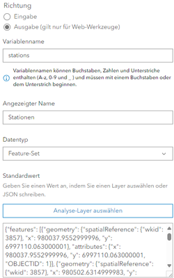

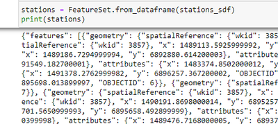

Even if the workflow changes from now on, as a different data set is used for electric charging stations, I end up with a FeatureSet with points (charging stations) around the route. I have also entered the dictionary of the charging stations as default in the parameter window.
I have added the codes to create the output parameters at the end of the script. I checked if the variables fit to the code from the parameters.

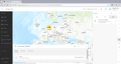

The tool runs without error message, but no result is created.

It seems like the tool in ArcGIS Online does not recognize the Output Parameters, because both FeatureSets won't show on the MapViewer.
When i open the history tap of the executed Task and click on the parameters ribbon, only the input-parameters show. Is that a problem? Should there also be output-parameters?

With a web tool that outputs the same FeatureSet (stations) you provided above, I see the same behavior where the tool completes without error while the FeatureSet is not displayed on the map. I also see an error in the console: "objectIdField not set and couldn't be found in the provided fields", which indicates the Object ID field is missing in the field list.

Which keys does the FeatureSet need to have?
Right now dictionary with a "feature":[] and a list of features. The feature look like this:
			"geometry": {
				"spatialReference": {
					"wkid": 3857
				"x": 980502.6314999983,
				"y": 6998179.386699997
			"attributes": {
				"y": 6998179.386699997,
				"OBJECTID": 2
each feature has a "x" and "y" attributes, because the sdf i created earlier had columns with these values and a SHAPE column.
Does each feature need a geometryType field or something else?
After the Features there are some other keys with values in the dictionary of the FeatureSet:
"objectIdFieldName": "OBJECTID",
	"displayFieldName": "OBJECTID",
		"wkid": 3857
	"geometryType": "esriGeometryPoint",
	"fields": [
			"name": "x",
			"type": "esriFieldTypeDouble",
			"alias": "x"
			"name": "y",
			"alias": "y"
			"name": "SHAPE",
			"type": "esriFieldTypeGeometry",
			"alias": "SHAPE"
Maybe that information helps to find the mistake in my Script.
Thank you very much!
