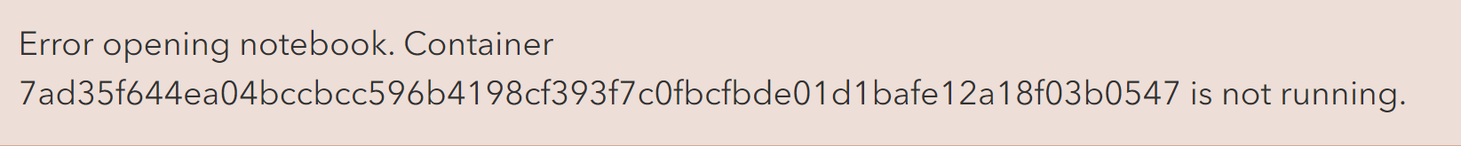

I have an Azure deployment multimachine 10.9 enterprise and when I try to open notebook it gave me this error.

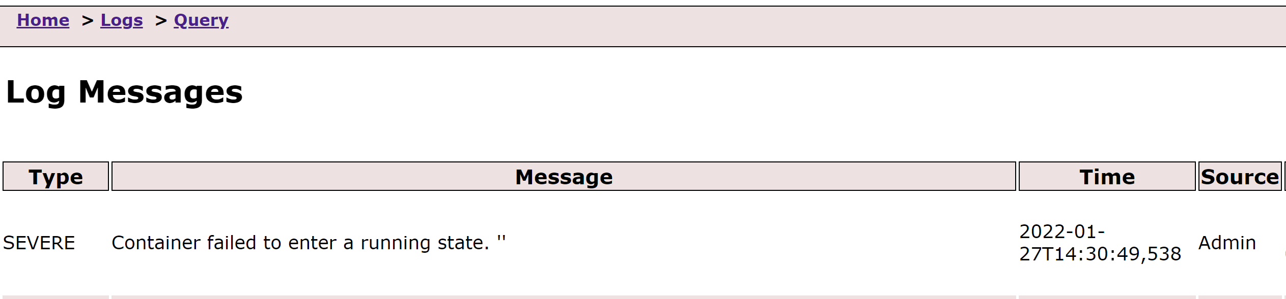

In notebook logs I get this

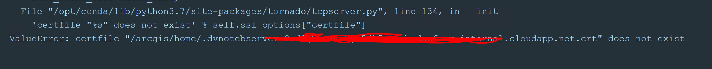

I checked Dockers and i notice that container is created but it stops after a second or two. In docker container log I found this certfile error.

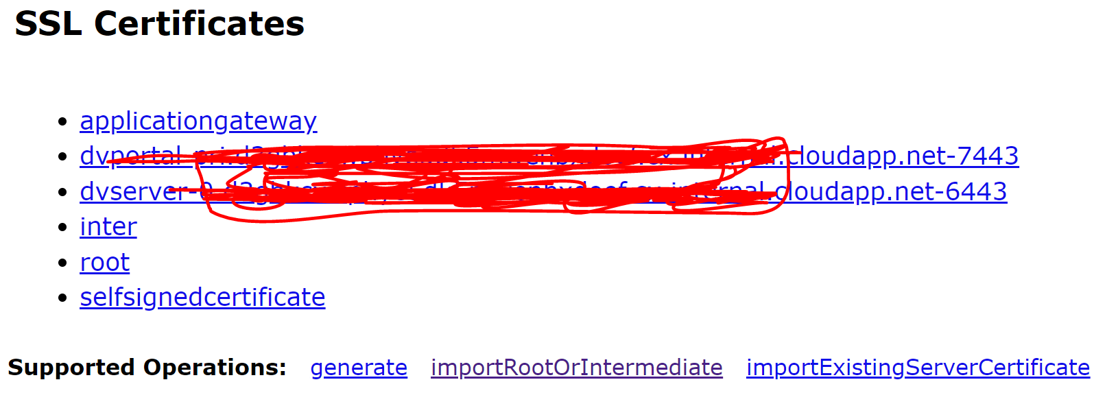

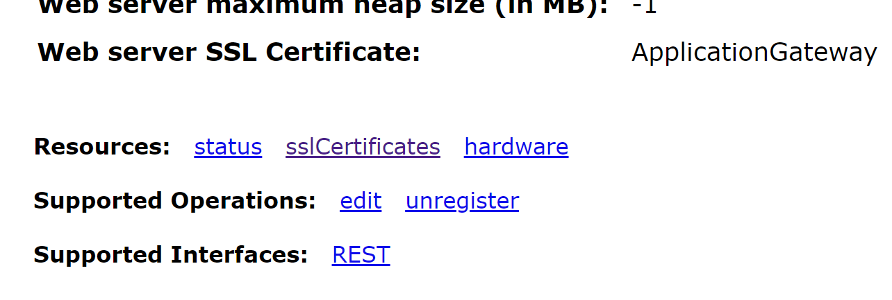

But in notebook manager I have all my certs in place, cloudbuilder automatically set appgateway in place
I also import my root and intermediate cert
I do not understand what could be wrong.

I was able get the error. In Docker error said something regarding Certificate. You need to know that certificate has a limitation of 64 Characters. In azure, VM fullname can be more than that, I had 67 characters for computer name plus domain name. So I had to redeploy and reduce VM Name in order to not pass 64 Characters,
After redeploy, reconfiguring Docker everything worked.
