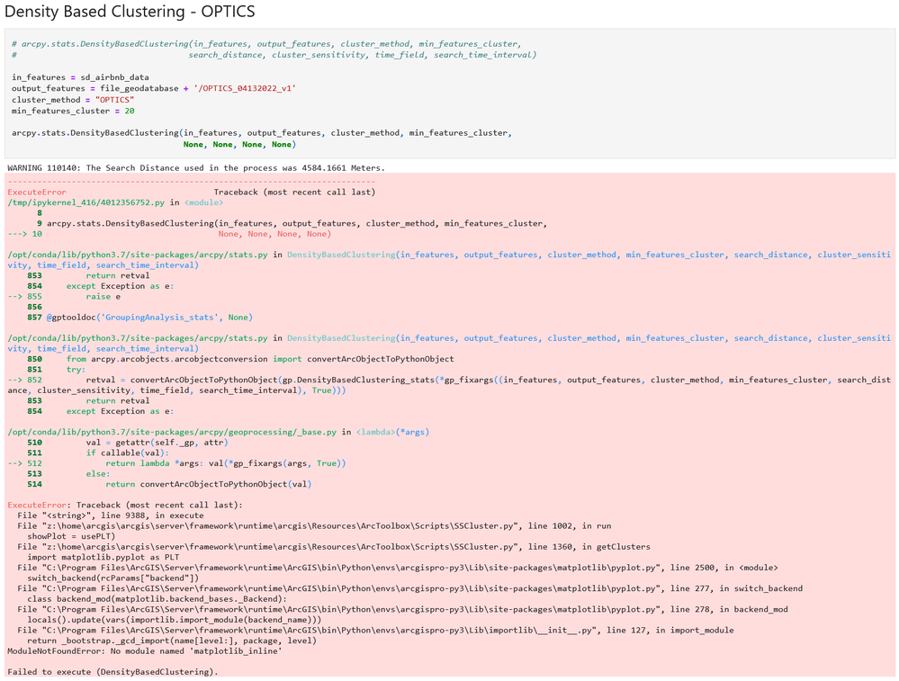

When running Density Based Clustering on AGOL, both DBSCAN and HDBSCAN produce output, but OPTICS does not - I'm using the same data/feature for all analyses - below is an image of the errors I receive for OPTICS...

anyone? we have been trying to solve this for a few weeks now. All other clustering runs fine, including the DBSCAN and HDBSCAN. its only when we try to run the OPTICS that the error occurs. Any help would be greatly appreciated!

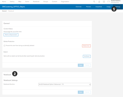

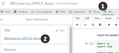

2. In your notebook item "Info"...
... can you please post a screenshot of what you see in the settings at the bottom for the notebook runtime?

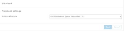

KellyMurphy1
Hi Alberto,
Thanks for the quick reply. Here are the screenshots you requested. Please let know if you need any other information, thanks!

When you have a moment, could you please try the following with your notebook and then attempt to run Density-based Clustering with the OPTICS method again to see if the problem is resolved?
1. Open your notebook item page, where you saw the notebook runtime dropdown.
2. Ensure the notebook is not open on any browser tabs.
3. Change the runtime to ArcGIS Notebook Python 3 Advanced - 7.0
4. Open the notebook and attempt to run Density-based Clustering with OPTICS.
Please let me know if you have a moment to run this and if the tool runs as expected in that new runtime.
