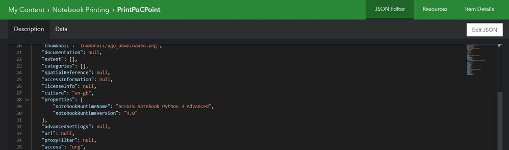

PhilipThompson11
Hi Lisa,
Click View Item JSON. Then you should be able to edit the json and the runtime version from there.

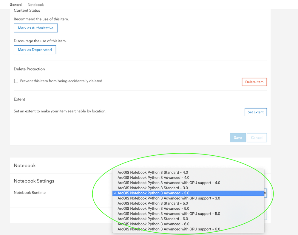

RaviNarayanan
Hi @PhilipThompson11 You should be seeing a dropdown like this - for selecting a runtime (type/version). Please let us know if this doesn't help. Will check out the exportToPDF use case.

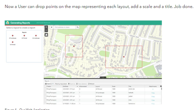

The red extents shown in the screenshot are a bit of smoke and mirrors in order to create a better presentation. The feature template is simply red dots - the centre of the extent. During the print process, I calculated what the extent of the map frame will be and placed them into a separate (polygon) feature layer. This was set to refresh and so gave a visual cue as to when the pdf had been picked up off the que and generated.
I spent some time messing round with CIMSymbols to achieve the effect you're looking for but it was a lot of effort and I couldn't get it to work.
