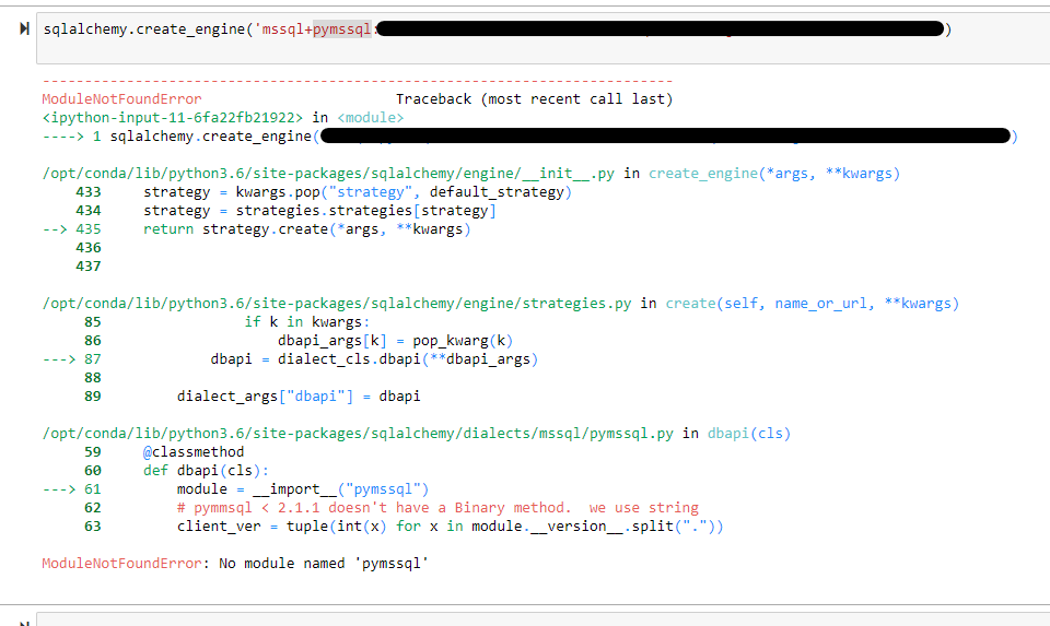

We have a really simple problem to solve. We want to connect our other SQL Server databases and bring the data into a pandas table. We use sqlalchemy but it returns errors that no submodule of pyodbc or pymysql exists. Obviously I then check the libraries document and I can't see them.
Apart from using an ETL and transferring data to a GDB or some other file or is there a different library we should be using?
Our linux system administrator couldn't get the libraries to load within the standard notebook "image" (esri precompiled deployment). Is there something we are missing?

Have you used pip to install pymysql?
I've had success connecting to MS SQL using pyodbc, but I think that also needed to be installed via pip.

To add to @WilliamOrr 's comment, when running code that uses python libraries not included in the Notebook runtime, you need to have a section at the beginning of your code to re-import the library because it won't be saved after the notebook finishes running
