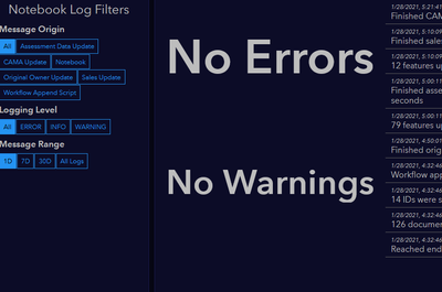

Building off of your idea and @Anonymous User's comment, we actually built our own "Notebook Admin Dashboard". Here's what we did:
  1. Create a standalone table with the following fields:
    • Timestamp
    • Level / Severity
    • Message
    • Origin
  2. Add some try/catch/finally to your notebooks
  3. Implement a "logging" process on the basis of step 2
    • Instead of logging to a traditional text file, submit log as edits to the standalone table form step 1
    • We use a custom "add_log(message, level, origin)" function to submit ours to make the rest of the script a little cleaner and easy to read
  4. Create a dashboard that references the standalone table
    • Table rows as a list element
    • Side / header bar with selectors for severity / origin / time range
    • Indicators for a single-glance view of "how many errors in past 24 hours", etc
If you wanted to take it a step further, you can even add webhooks to the standalone table layer to send emails when there are certain edits.
