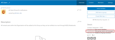

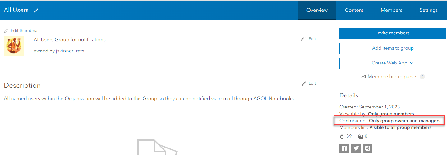

1.  First step is to create a Group in AGOL.  Since any user could potentially be notified, all named users have been added to this group, All Users.  No content needs to be shared to this Group, so I’ve set the Contributors to only the group owner and managers:

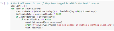

5.   Check which users have not logged in within 90 days.  Disable those accounts, and add that username to a list called userList
