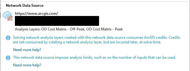

I am trying to get average commute times from around the metroplex using the network analyst tools provided by ESRI. So using their network layer instead of one I've built myself.
From everything I've read, it should automatically use historical traffic data. But I'm not seeing that it does (unless it's just wildly inaccurate). I am running the tool twice, once at 'peak traffic' (set at 7:30am) and once at 'off-peak traffic' (set around 10pm). I would expect there to be massive differences in time it takes but even when I know there should be at least a half hour difference, it only shows about a 5 minute difference.
Am I using the tool wrong? Since I only care about the time I am running an OD Cost Matrix analysis. I have the Date and Time section set for Day of Week, Wednesday, 7:30am.
The source is AGOL.
Am I just running it wrong?
Info: Running the tool in ArcGIS Pro 3.4.2

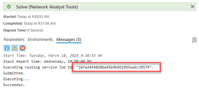

MaxZeng
Btw, Heather, in the history pane, each solve to ArcGIS Online should write out a job id in the messages. If you could share the two job ids (the peak solve, and the off-peak solve), then I can take a look at the request parameters as well to confirm whether the settings are correct.
HeatherScroggins
Hi Max,
Here are the two job IDs:
Peak: jf6b53aa38f1a475db85ce41973b3103b
Off-Peak: j364c829ee6844016ad0416e339416a56
