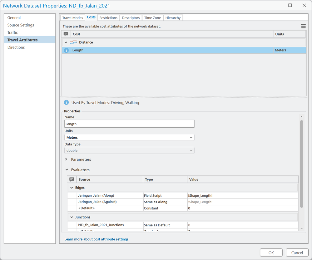

Since the information needed for costs, restrictions, and travel mode in the road network attribute table is sadly very limited, this is the cost (pic 1) and travel mode (pic 2) settings that I came up with
Cost(s): Distance

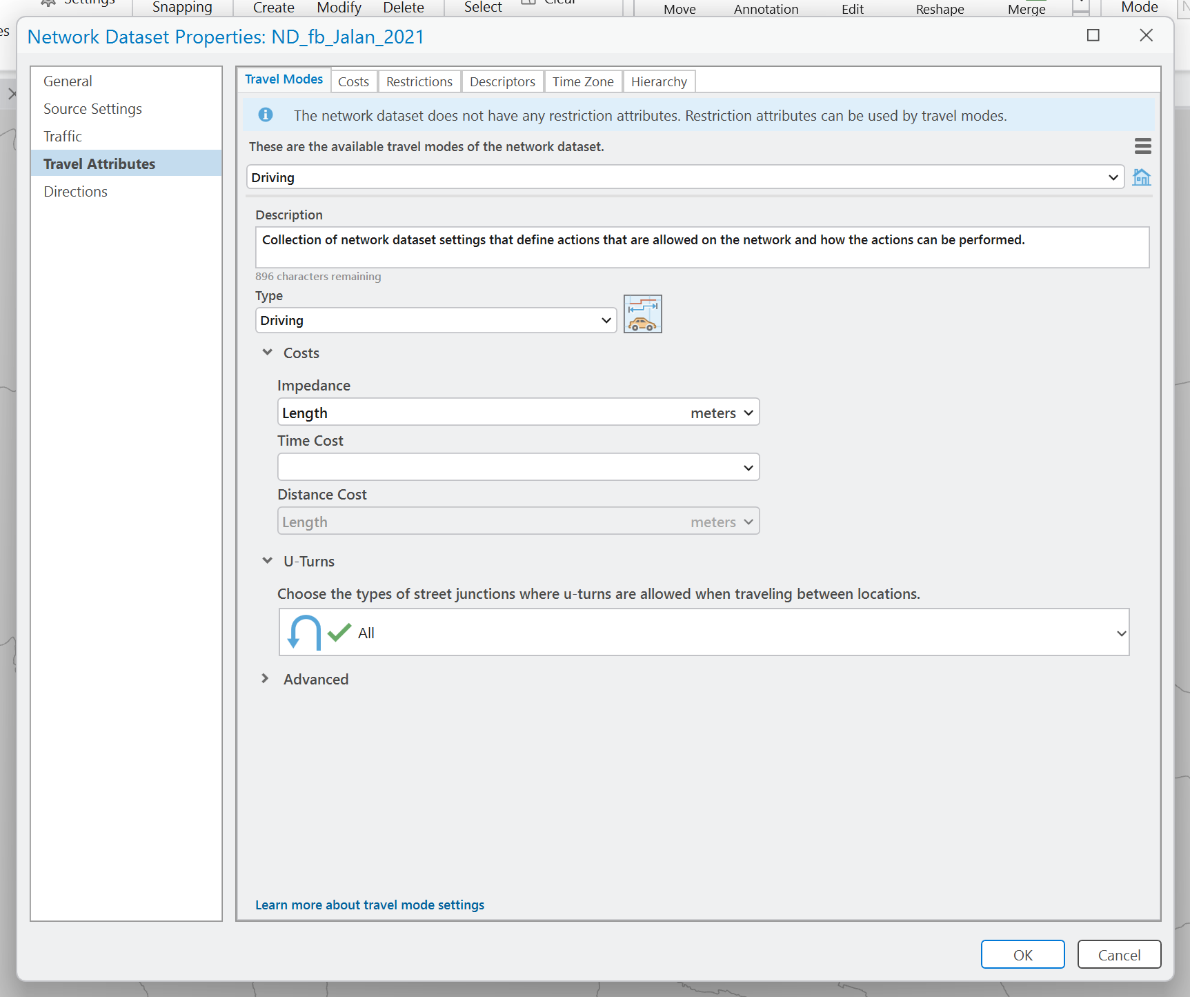

 Travel Mode Settings

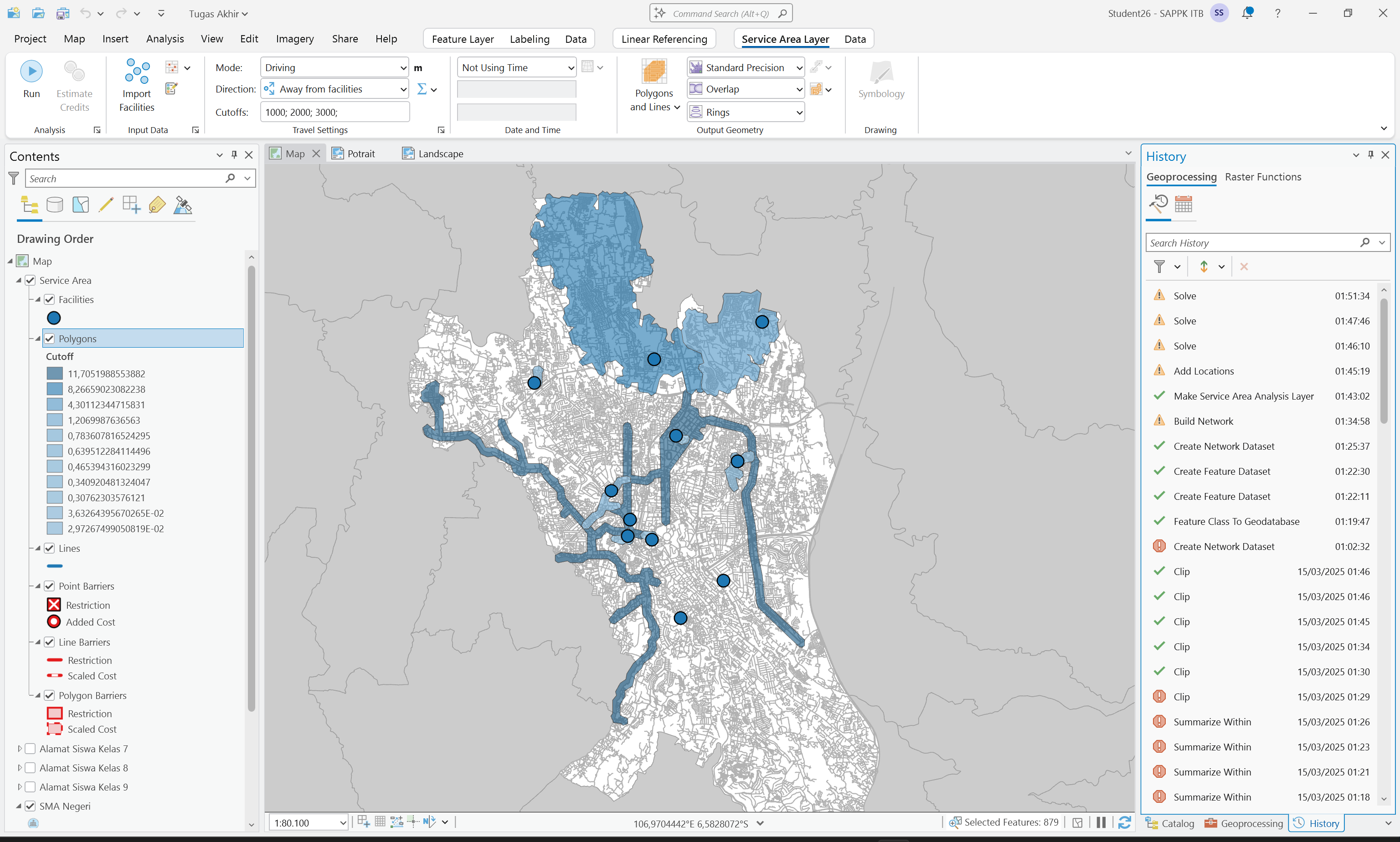

But the result came out like this and the cutoff is nowhere near what I intended. The service area of some of the facilities are also very small, as you can see the two points at the bottom part seems to not have service area if you see it in this scale (about 1:80.000), but if you zoom to the feature it has a service area

Service Analysis Result
I Googled and tried several things (like changing the cutoff to see if it came out right, input an equation on Distance costs evaluator's value to convert Shape_Length from meter to kilometer, Force Full Builds option checked/unchecked, even Typology to check any unconnected lines) but none seem to work.
My suspicion is I failed to identify the root cause(s) correctly or I can't formulate the right keywords that match my problem. However, I have several hypotheses as what could be the root cause(s)

I think you're on the right track with your testing so far.  To me, it looks like it's probably some sort of connectivity problem.  It might be a topology issues  (gaps, dangles, poorly connected streets).  Or it might just be something you can fix easily by adjusting the network dataset's connectivity policy from End Point to Any Vertex.
If your street features are split at every intersection (they intersect at endpoints of features), then End Point connectivity (the default) is appropriate.  However, if your street features are long and intersect with many other features at junctions instead of endpoints, then you should instead use Any Vertex connectivity.

abdinafan
Thank you for the answer!
My problem is solved now by changing the dataset's connectivity policy to Any Vertex. I understand now that my road network .shp consist many road sections that made up by several parts, the default connectivity policy (End Point) is 'confusing' the algorithm
