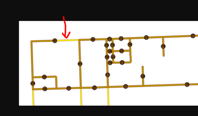

@JaySandhu can you shed any light on this? I am running into the same issue currently. Even though there is a road present. Can it be an issue with the online service network?
JaySandhu
Can you provide any more information on how you are solving this? Is it using the ArcGIS Online routing service or using your own local data? Generally a message like this means there is no path to the location which could be because the underlying network data may have some connectivity problem.
Jay Sandhu
RobertBeckerGIS

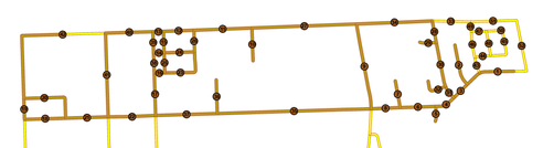

@JaySandhu  in my particular scenario I am using the ArcGIS Online Routing service.
I have generated midpoints off the street centerlines and it seems to be working well besides some areas are not completing.
Brown = the route generated
Yellow = The underlying streets
Also am wondering why it is not completing into a single route? Is there a way to set the start and stop as the same point so it comes to a complete loop?
JaySandhu
The route solver does not close a loop. If you want to return to start location then you have to add it as the last stop with Preserve First and Last stop option.
For the unreachable streets, there maybe some restriction (gated community or limited access road) that is blocking the visit to that neighborhood.

RobertBeckerGIS
@JaySandhu I tried to preserve the first and last stop option but was having trouble doing so. Would you add a duplicate stop that is "1" in the sequence but then the duplicate is the last number?
Understood on the unreachable streets. Is there anyway to manually edit the route after it is generated? Since I can see from aerial imagery there should be public access.
JaySandhu
When you add a duplicate first stop as the last, you have to give it the max sequence number as that is what determines the first and last. So if you have 50 stops. Then the start stop is added as sequence 1 and again as sequence 51.
You can change the restrictions that are being used before you solve the route so that it can enter restricted areas. As far as editing a route after the fact, well, it is a simply a line feature, you can edit it with editing tools.
