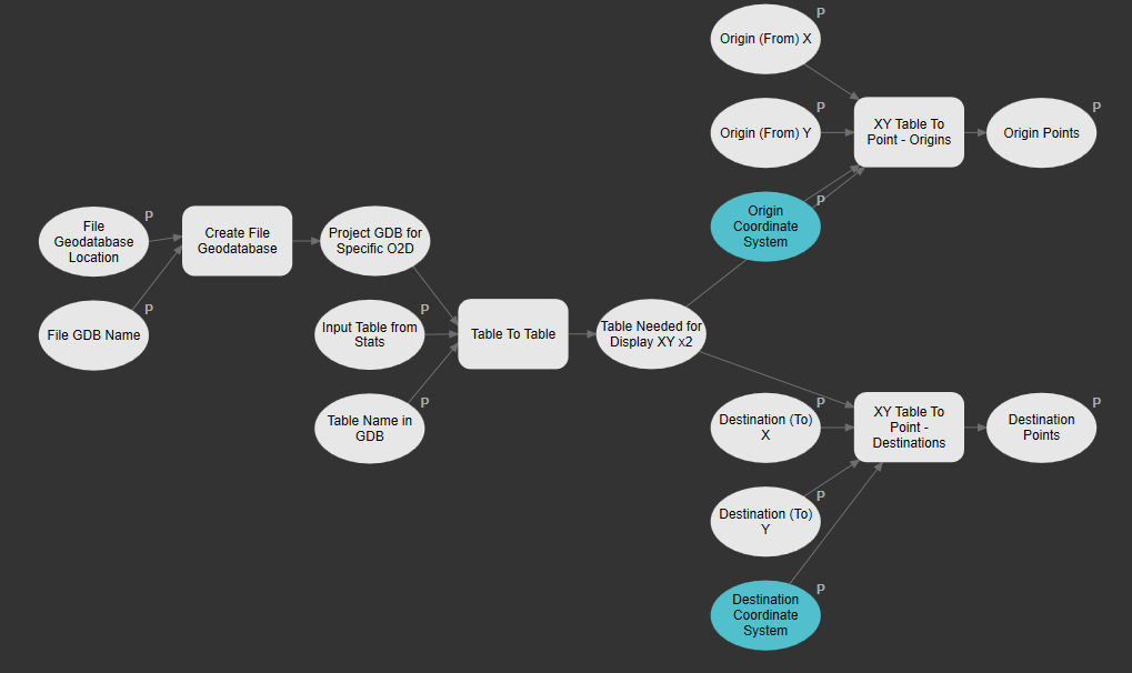

Part 1 works:
Part 2 and its ability to successfully connect to Part 1 is where I'm looking for help.

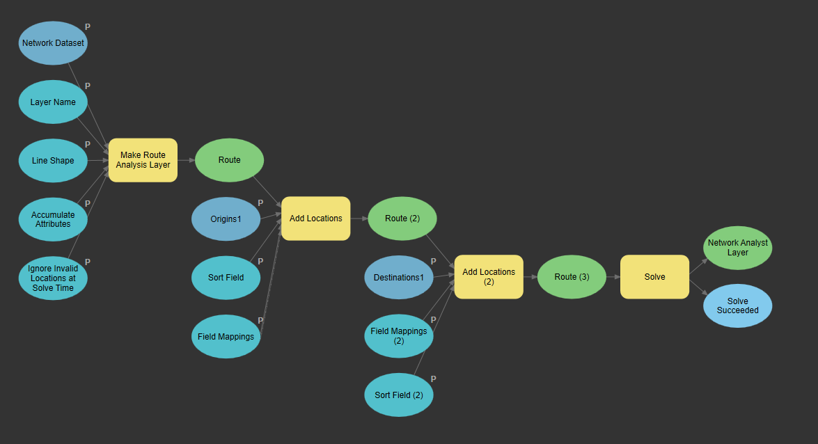

Here is part 2 so far:

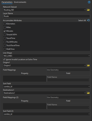

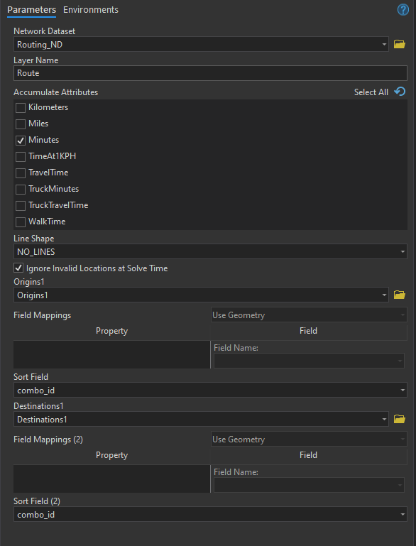

When I tried running the part 2 model as-is, it generated 1 route with 200 stops. I need 100 routes with 2 stops (correctly connecting the predetermined origins/destinations). When doing this manually, the Add Locations tool's field mappings are key to adding the origins and destinations correctly as Stops into the Route Analysis layer. They have a combo_ID in common that I need assigned to both the origin and destination RouteName in field mapping. Additionally, I use the combo_ID in the sort field to doubly make sure origins and destinations are being loaded in the same order. I also have a from_ID and to_ID I use as the 'Name' field mapping when adding locations for origins and destinations, to ensure both sets of stops have unique IDs as well.
In modelbuilder, I can apply those settings to the Add Locations tool, but when I turn Field Mappings into a parameter so it can be used as a geoprocessing model, the field mappings remain grayed out and cannot be specified. I imagine this is why I'm getting 1 route with 200 stops, I don't know how to parameterize the field mappings each time I add locations in modelbuilder. Any idea how to get that working?

I'm ok keeping this workflow as 2 separate models for the time being, but I'd also ideally want to successfully connect them as one model, but the origin and destination points generated in part 1 wouldn't turn into parameters either. Any suggestions on how to connect part 1 and part 2 into 1 geoprocessing model?

Hi Rachel.  I'm not really surprised that this isn't working.  The Add Locations tool doesn't have access to the schema information about the output of Model 1, so it can't construct the field mapping reliably.  I'm not really sure how you could get this to work.  Maybe you could put all of it in one model, and if it was validated or run once, Add Locations might be able to figure it out.  But in general I think this strategy is pretty iffy, and I wouldn't recommend it.
If you can change your combo_ID fields to RouteName in advance, that might make it work because the field mapping will happen automatically.
