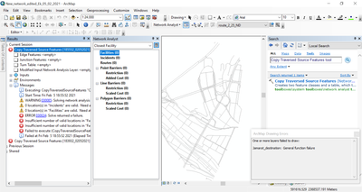

I followed your suggestion and uploaded the closest facility layer, however, its not executed properly. the message response as following :
any help to figure out ?
Many thanks in advance,
Muteb
MelindaMorang
The problem is that your Closest Facility analysis is failing to solve because it has no incidents and facilities in it. You need to first configure your Closest Facility layer and add the desired inputs, then solve it. Once you are convinced that the results are as expected, then you can run Copy Traversed Source Features.
Here is a tutorial to help you learn how to set up a Closest Facility analysis: https://desktop.arcgis.com/en/arcmap/latest/extensions/network-analyst/exercise-4-finding-the-closes...
MutebAlotaibi
Now , it runs properly but the output is empty table??
MelindaMorang
This page explain the output of the Copy Traversed Source Features tool: https://pro.arcgis.com/en/pro-app/latest/tool-reference/network-analyst/copy-traversed-source-featur...
If the routes do not travel over edges, junctions, or turns, then the associated output table will be empty.
