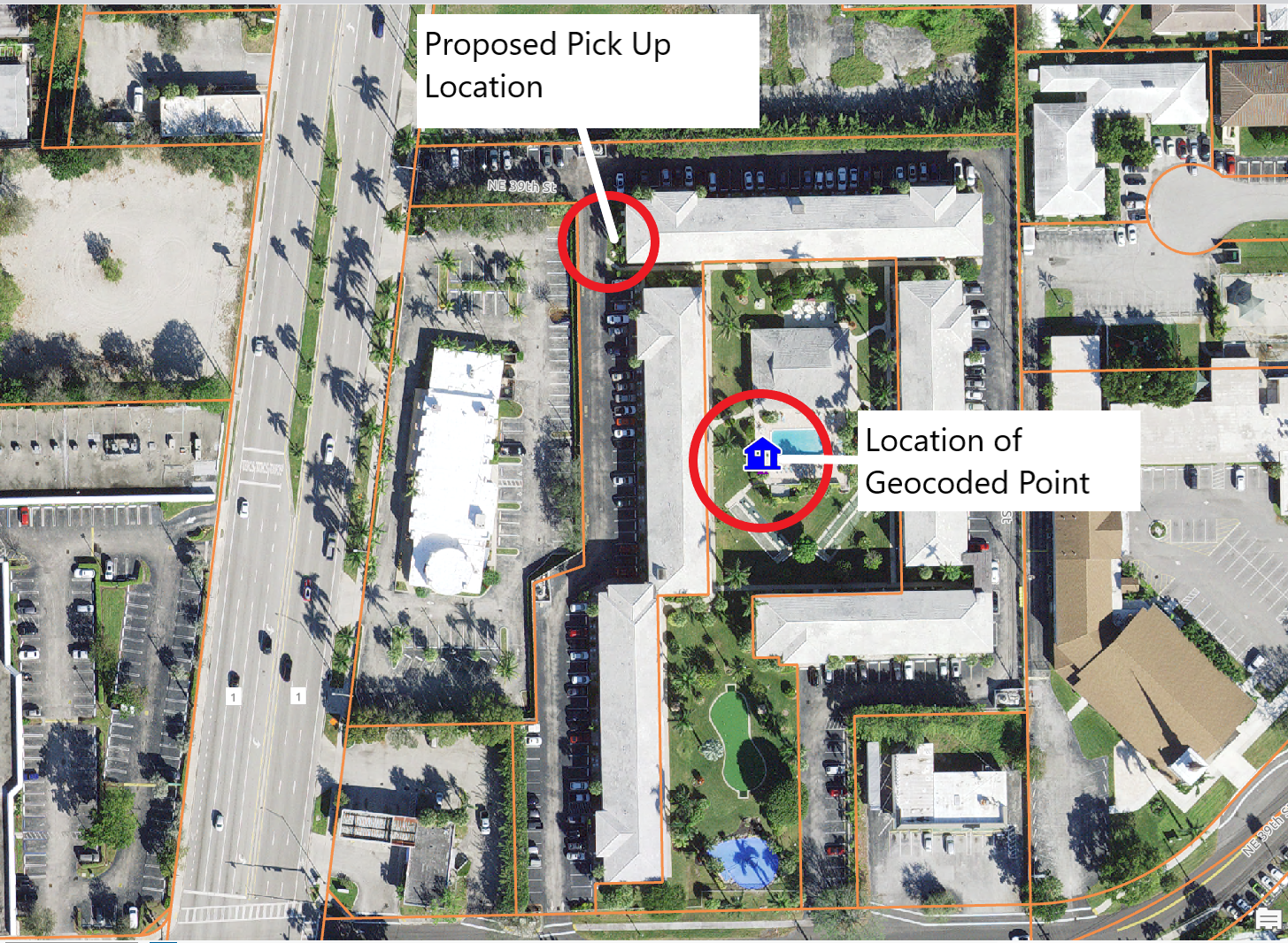

1. We are tying to create a three route solution for about 70 clients. We have the addresses geocoded. After we create a street network, do the address points need to be at the parcel address or at the location of pick up? For example, some clients live in apartment complexes that have specific pick up points for passengers. This is not always the main entrance.

For 1: The locations where you want to route to should be at the point of pickup/drop off. Having a roof top location or a parcel centroid may have that location snap to a wrong location for routing purposes.
