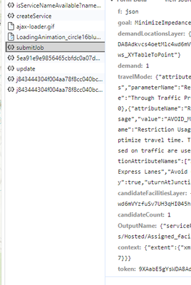

1. Turn on debug logging
2. Run Analysis in Pro (like an end user)
3. If still failing and nothing in the logs; try in Portal with the same data but uploaded.
4. If still failing and nothing in the logs; access the developer tools in your browser and you can extract the json of the data from the network tool under submitJob and you can just place that in the html REST endpoint located here: https://machine.domain.com/webAdapter/rest/services/Routing/NetworkAnalysis/GPServer/FindClosestFaci...
Then at least you know nothing else is getting in the way and the entire thing is borked.

Unfortunately no, the routing JSON in the REST API would return null even though every logging message says there should be routes. I have been working with several ESRI folks, but unfortunately nobody could figure it out and we have another server that is on 11.3 so we are just going to reinstall it on the other server and my understanding is that the install process on 11.3 has been significantly simplified.
