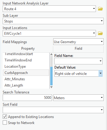

I am trying to create routes for stops along a walking route.  The current solve is alternating across the street I would like the route to stay on one side of the street and then come back down the other side for safety of the walker.  How can I setup the network dataset to give me these results.  I think I need a restriction on crossing the street but I am not sure.
Lim_Shane
For anybody who finds this.  The answer was not to actually make any changes to the network dataset.  I simply had to set the CurbApproach value on the stops to be right side of vehicle.  In my case I set this as the default value when I imported my stops.

I set the restriction to high on the intersections but how does that affect the street itself.  Based on the routes I have now the road itself seems like it needs some sort of restriction.  In the attached photo the route isn't crossing at intersections its crossing everywhere.

I should ask: do your pedestrian routes have their own edges? As in, are the sidewalks / paths digitized? Your screenshot lots like it's just routing along the road itself. It's only "crossing" if you connect the stops in numeric order, but the route itself is linear.
If you're just using the road network itself for pedestrian routing, I think it's still possible. Take a look at Locating Analysis Inputs. I think if you specify the SideOfEdge attribute to "right", your route should go up, then back, in order to hit all the stops with that constraint in place.

I'm glad you found a solution that works, but keep in mind that this assumes that you're always going to be walking along the right-hand sidewalk in the direction of travel. Depending on the arrangement and number of stops you have, this may not always work.
