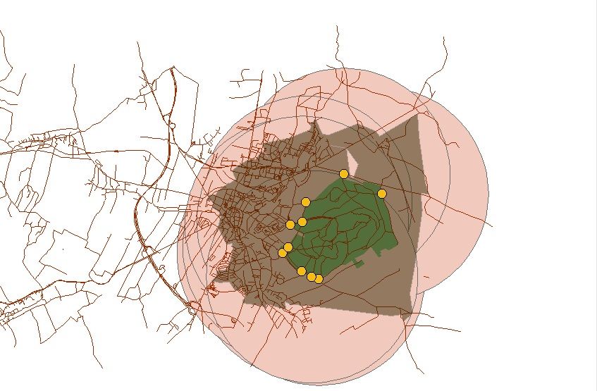

Hello all!
I want to check the percentage of a city that is accessible to a forest (in green in the image) within a 2 km range from its entry points (purple dots). My first approach consists in creating buffers with a 2 km radio (blue circles) from the entry points. For a more realistic one, I am using Service Network Areas (ArcGIS 10.7) to use the network of streets of the city with the same distance limit (orange polygon). I got the network of streets of the city from openstreetmap and then I cleared it from rivers, streams, electric lines, railways and such. From the polyline shape I created a new network Dataset with only length in meters as attribute, and then created a New Service Area and loaded the 10 entry points of the forest as facilities. For the polygon creation I am merging the polygons and not trimming them (I'm also using Disk as overlap, even though I don't think this is important in my case, since I have only one break). The default break is 2000 m, which is the limit I defined for my study.
As you can see in the image, the maximum distance that could be covered should be the direct approach using the blue circles buffers. Nevertheless, the Network Service Area exceeds this maximum direct distance on some areas, reaching a distance of 2600 m from the entry points, for example. Whereas the limits of the Network Service Area polygon should be shorter than the direct approach, since the distance is being measured by using the network of streets. I am new in using this tool, therefore I don't know if I am overlooking something or making a mistake in my procedures.
I would greatly appreciate your help and comments.

There may be a projection issue, The length attribute of the roads may be mismatched with the dataframe projection if you've done a planar buffer. Try creating geodesic buffers in the first instance if you haven't already done so.

Is this a web mercator projection?
... sort of retired...
VictorManuel
Yes, Dan, it is. I will change the projection to see if the same mistake keeps coming.

The reason I ask is Web Mercator is useless for distance and area measures.  Make sure you are buffering, running analyses and measuring in a projected coordinate system that is appropriate

Thank you, Dan. Indeed, it was the one that I got from the openstreetmap transformation and I kept it for simplicity reasons, I didn't know it was such a bad one. I will re-project and check again the results to come back to you.

Thank you, Dan! I converted everything to UTM33N (which applies for my case study) and now everything makes sense. See the pic attached. Rookie mistake haha

I have re-projected everything to UTM33N and now the Service Network Area makes sense. I also used geodesic buffers this time. Thank you for your help!
