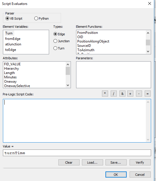

In script evaluators how element variables work?
The following Element Variables are available:
  • Turn
  • fromEdge
  • atJunction
  • toEdge
Does "fromEdge" mean the previous edge and "toEdge" the next edge? Is there any documentation for Element Functions such as ToAzimuth, FromPositin, PositionAlongObject etc?
PatrickStevens
The network element script evaluators are based on the ArcObjects API.  To explain some of the sections of the dialog in your screenshot:
  • Element Variables: These are the objects that you can reference in the code block.  For evaluating edges, the only valid element variable is the Edge element itself.  In your screenshot, you see Turn, fromEdge, toEdge, and atJunction.  These are all network elements associated with a Turn.
  • Types: This changes the available functions in the Element Functions section.  For example, select Turn and you get the Angle function.  Select Junction and you get the TurnCount function.
