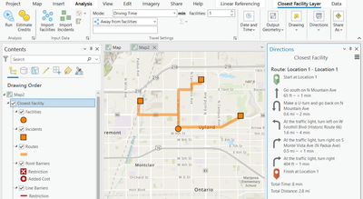

There are couple of different ways to solve this. Do you need three routes, to each of the school from the same starting location (police car location)? So, you can use the route solve, three different times OR you can use the Closest Facility Solver. Load the police car shape file as the facility. Load the three school locations from the second shape file as incidents. Set the travel direction to travel from Facility to Incident and solve. This will give you three separate routes. See screenshot below.
