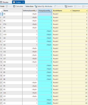

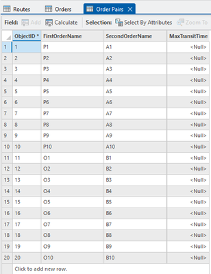

Thanks again for your detailed message. I took some time to replicate the scenario you described, focusing specifically on using Order Pairs only (without route renewal).
Here’s what I did:
Created 10 pickup-drop-off pairs for each destination (Location A and Location B).
For each person:
  • The PickupQuantity_1 on the pickup order was set to 1.
  • The corresponding drop-off order had a DeliveryQuantity_1 also set to 1.
Routes were constrained only by MaxCapacity, which was set appropriately (e.g., 5), with no route renewal enabled. The constraint MaxOrderCount is a required field for VRP so in this case it needs to be set high enough to not artificially limit the problem. It will limit the total number of order locations (both pickup and drop off counted separately) for a route. It can be set to the total number of orders in the problem.

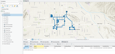

In this setup, the routing engine correctly scheduled multiple trips to serve all orders across the route (e.g., first group dropped off before starting the second group), without returning to the depot between runs.
I’ve shared screenshots of my project settings for reference. The orders labeled P1–P10 represent people going to Location A, and O1–O10 represent those going to Location B.
