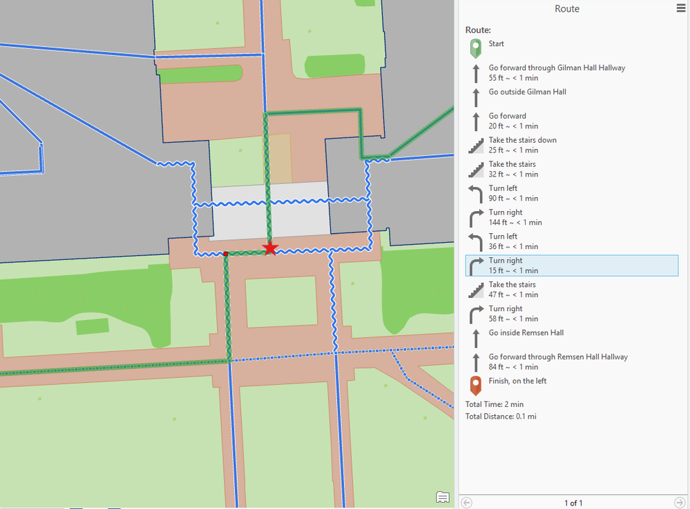

I noticed that steps in my pedestrian Route network analysis layer that require turning then navigating stairs only mention the stairs and not the turn.
See example in my image below. After the selected step Turn right, the next step is to take the stairs, however first the user needs to turn left (at the red star markup). The next step correctly instructs the user to turn right.
Is this behavior expected?

In general that is the expected behavior, the directions to take stair don't include "turn" guidance.

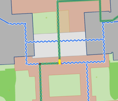

To get a turn maneuver before the stairs you could probably add a small "path" feature, like in the yellow below.  So this would produce a something like
Turn right
Turn left
Take the stairs

Shelby_Kline
Thanks for replying, Frank!
It's unfortunate that there's no option to configure a step such as "Turn left, then take the stairs". I'll post that as an idea. Until then, splitting many stair features. 🙂
