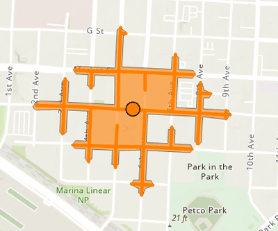

Adding on to what Melinda posted, here is what a 1000 foot service area lines and polygon with a 10 meter trim looks like using Network Analyst:
