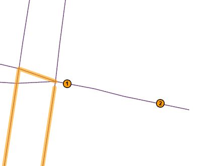

I am trying to add a new segment to a network, but after rebuilding the network I can not route along the segment. It shows up in the edges, but its not being recognized for routing. I have no problems with this in ArcMap, but Pro I can not get this to work. Any ideas? I posted an image below of two stops and what the route is trying to do, which is not correct. Thanks in advance!

It isn't clear from the image what the 2 stops are supposed to do and what the highlighted lines mean?
Can it be assumed that you have confirmed that the line additions are snapped correctly to the existing geometry?

melisahansen
Topology has been checked, so connectivity should not be a problem. I checked and there were no errors when building the network. Also, Elevation fields are all set properly.
How would you check if only a specific edge is restricted? All the attributes of the new line match the required attributes of the network, so I'm not sure what could be wrong or how to even check if its restricted.
