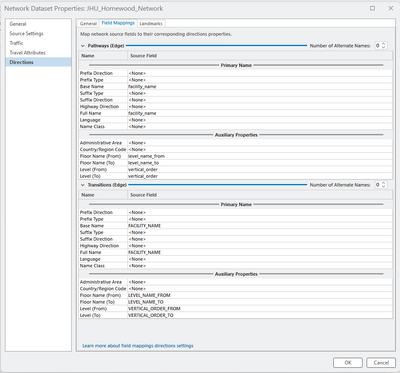

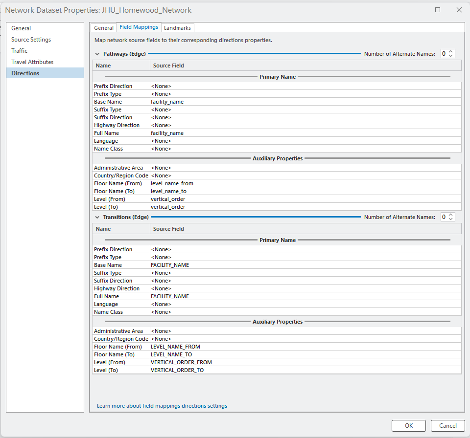

What field mappings can be used, if any, to generate a direction step instructing users to enter a building?
With my current network settings, route directions do not indicate when a user enters a building. Is this feature available with the correct field mappings?
I was thinking about using Administrative Area to generate steps like "Enter Gilman Hall", but that probably isn't the recommended method. 🙂
I am using ArcGIS Pro 3.5 and Enterprise 11.5.

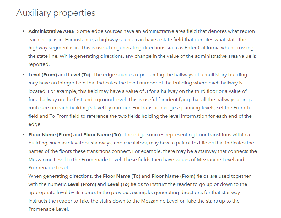

Using Administrative Area is the correct way to include in the directions info about entering an 'area', in your case a building.

Thanks for your response! I just tested this out in Pro and the directions now say to "Go inside Gilman Hall" upon entering and "Go outside Gilman Hall" upon exiting the building. Just what I was looking for 😁
