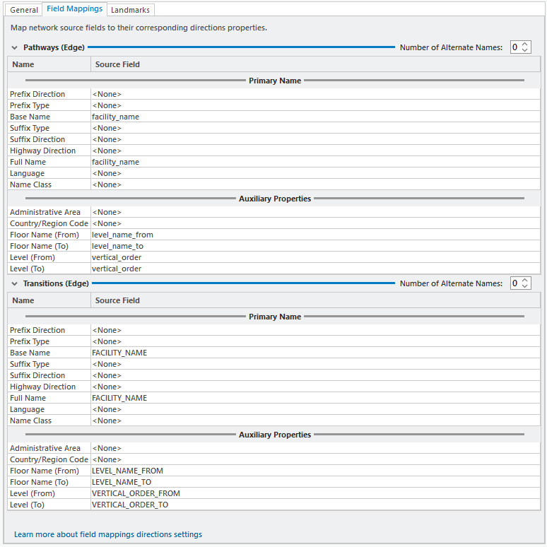

I'm looking to add references to floor level in the step-by-step directions of my Route Analysis layer. I followed the Configure Directions guidance to create a new descriptor for the Feature Category network attribute that maps my path types to Esri's road classes.
Floor Name (From), Floor Name (To), Level (From), and Level (To) are all mapped to the correct fields.

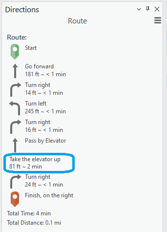

The directions now reference the elevator with instructions to take it up or down but do not include the floor name.

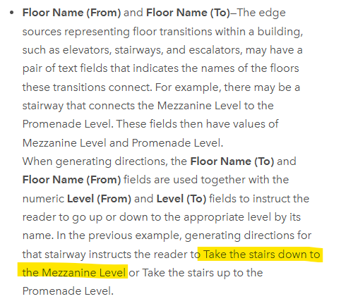

Are there additional settings or mapping I might be missing? My current configuration seems correct according to the bullets under the Auxiliary Properties section.

This seems to be a bug with the versions of ArcGIS Pro (3.3) and Enterprise (11.1) I'm using. Hopefully it will be resolved once we update to Enterprise 11.4 or 11.5 and a compatible version of Pro.
